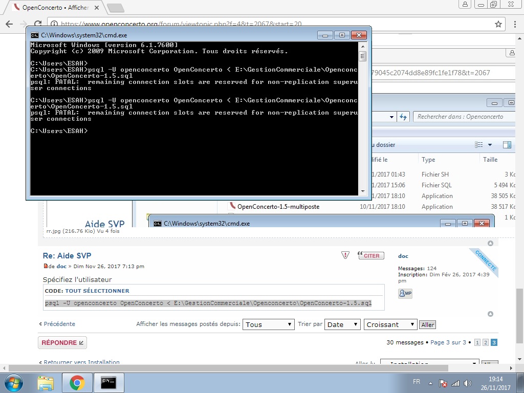

Cette fois c'est parceque trop de connections ont été ouvertes, redémarrez le pc et retapez la ligne de commande.

UncaughtException on thread Thread[main,5,main]
java.util.concurrent.ExecutionException: java.lang.IllegalStateException: Impossible d'obtenir une connexion sur jdbc:postgresql://127.0.0.1:5432/OpenConcerto
org.openconcerto.utils.ExceptionHandler: UncaughtException on thread Thread[main,5,main]
at org.openconcerto.utils.ExceptionHandler.handle(ExceptionHandler.java:121)
at org.openconcerto.utils.ExceptionHandler.handle(ExceptionHandler.java:125)
at org.openconcerto.erp.config.Gestion$2.uncaughtException(Gestion.java:198)
at java.lang.Thread.dispatchUncaughtException(Unknown Source)
Caused by: java.lang.IllegalStateException: java.util.concurrent.ExecutionException: java.lang.IllegalStateException: Impossible d'obtenir une connexion sur jdbc:postgresql://127.0.0.1:5432/OpenConcerto
at org.openconcerto.sql.PropsConfiguration$Addable.get(PropsConfiguration.java:993)
at org.openconcerto.sql.PropsConfiguration.getDirectory(PropsConfiguration.java:1104)
at org.openconcerto.erp.config.Gestion.main(Gestion.java:309)
Caused by: java.util.concurrent.ExecutionException: java.lang.IllegalStateException: Impossible d'obtenir une connexion sur jdbc:postgresql://127.0.0.1:5432/OpenConcerto
at java.util.concurrent.FutureTask.report(Unknown Source)
at java.util.concurrent.FutureTask.get(Unknown Source)
at org.openconcerto.sql.PropsConfiguration$Addable.get(PropsConfiguration.java:989)
... 2 more
Caused by: java.lang.IllegalStateException: Impossible d'obtenir une connexion sur jdbc:postgresql://127.0.0.1:5432/OpenConcerto
at org.openconcerto.sql.model.SQLDataSource.getRawConnectionThrow(SQLDataSource.java:1376)
at org.openconcerto.sql.model.SQLDataSource.getRawConnection(SQLDataSource.java:1394)
at org.openconcerto.sql.model.SQLDataSource._borrowConnection(SQLDataSource.java:1334)
at org.openconcerto.sql.model.SQLDataSource.borrowConnection(SQLDataSource.java:1321)
at org.openconcerto.sql.model.SQLDataSource.getNewConnection(SQLDataSource.java:1301)
at org.openconcerto.sql.model.SQLDataSource$QueryInfo.<init>(SQLDataSource.java:701)
at org.openconcerto.sql.model.SQLDataSource.execute(SQLDataSource.java:610)
at org.openconcerto.sql.model.SQLDataSource.execute(SQLDataSource.java:554)
at org.openconcerto.sql.model.SQLDataSource.getSchema(SQLDataSource.java:1878)
at org.openconcerto.sql.model.SQLDataSource.getSchema(SQLDataSource.java:1860)
at org.openconcerto.sql.model.DBSystemRoot.setRootPathFromDS(DBSystemRoot.java:632)
at org.openconcerto.sql.model.DBSystemRoot.setDS(DBSystemRoot.java:628)
at org.openconcerto.sql.model.SQLBase.<init>(SQLBase.java:142)
at org.openconcerto.sql.model.SQLServer.createBase(SQLServer.java:419)
at org.openconcerto.sql.model.SQLServer.getBase(SQLServer.java:408)
at org.openconcerto.sql.model.SQLServer.createSystemRoot(SQLServer.java:467)
at org.openconcerto.sql.model.SQLServer.getSystemRoot(SQLServer.java:445)
at org.openconcerto.sql.model.SQLServer.getSystemRoot(SQLServer.java:425)
at org.openconcerto.sql.PropsConfiguration.createSystemRoot(PropsConfiguration.java:608)
at org.openconcerto.erp.config.ComptaPropsConfiguration.createSystemRoot(ComptaPropsConfiguration.java:747)
at org.openconcerto.sql.PropsConfiguration.getSystemRoot(PropsConfiguration.java:1043)
at org.openconcerto.sql.PropsConfiguration.createRoot(PropsConfiguration.java:390)
at org.openconcerto.sql.PropsConfiguration.getRoot(PropsConfiguration.java:1033)
at org.openconcerto.sql.element.ConfSQLElement.<init>(ConfSQLElement.java:35)
at org.openconcerto.sql.element.ConfSQLElement.<init>(ConfSQLElement.java:30)
at org.openconcerto.task.config.ComptaBasePropsConfiguration.createDirectory(ComptaBasePropsConfiguration.java:183)
at org.openconcerto.erp.config.ComptaPropsConfiguration.createDirectory(ComptaPropsConfiguration.java:767)
at org.openconcerto.sql.PropsConfiguration$1.create(PropsConfiguration.java:243)
at org.openconcerto.sql.PropsConfiguration$1.create(PropsConfiguration.java:1)
at org.openconcerto.sql.PropsConfiguration$Addable$1.call(PropsConfiguration.java:969)
at java.util.concurrent.FutureTask.run(Unknown Source)
at org.openconcerto.sql.PropsConfiguration$Addable.get(PropsConfiguration.java:987)
... 2 more
Caused by: org.postgresql.util.PSQLException: FATAL: remaining connection slots are reserved for non-replication superuser connections
at org.postgresql.Driver$ConnectThread.getResult(Driver.java:348)
at org.postgresql.Driver.connect(Driver.java:271)
at org.apache.commons.dbcp.DriverConnectionFactory.createConnection(DriverConnectionFactory.java:38)
at org.openconcerto.sql.model.SQLDataSource$4.makeObject(SQLDataSource.java:1584)
at org.apache.commons.dbcp.BasicDataSource.validateConnectionFactory(BasicDataSource.java:1556)
at org.openconcerto.sql.model.SQLDataSource.createPoolableConnectionFactory(SQLDataSource.java:1599)
at org.apache.commons.dbcp.BasicDataSource.createDataSource(BasicDataSource.java:1388)
at org.apache.commons.dbcp.BasicDataSource.getConnection(BasicDataSource.java:1044)
at org.openconcerto.sql.model.SQLDataSource.getRawConnection(SQLDataSource.java:1386)
... 32 more
Messages : 202
dim. nov. 26, 2017 7:41 pm
Toujours le nombre de connections qui pose problème, vérifiez le nombre max de connections dans le fichier postgresql.conf, quel est la valeur de max_connections. Pour y remédiez temporairement redémarrez le pc mais c'est pas normal que vous atteigniez comme ça le max de connections.
esah
Messages : 29
Enregistré le : jeu. nov. 16, 2017 6:40 pm
dim. nov. 26, 2017 7:44 pm
max_connections = 100
Messages : 202
dim. nov. 26, 2017 7:46 pm
Le nombre est correcte mais passez le à 200 et redémarrez le pc
